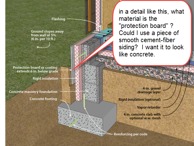

Protection Board ?
Not an ArchiCAD question I know, but perhaps someone knows what could be used for this.

I'd use a 9mm (3/8 inch) thick apiece of compressed fibre cement. Resistant to impact damage and moisture
Steve Jepson
Thanks sboydturner,
But what product is that? Will HardiePlank® Lap Siding work for that ?
Will it resist the moisture in the ground?
gpowless
The protection board is usually concrete board like this http://www.durock.ca .
The protective coating would be a cementitious coating approved for applications over eps such as this http://styro.net/TuffIIFoamAndICFCoating.html
What the detail misses is a free-draining membrane or porous backfill should be located below the parging in frost areas to prevent frost heave damaging the coating.

Steve Jepson
Durock, Denshield, Hardiebacker... would be fine but they don't come in a size that is efficient for this purpose. Too much cutting and patching.
I was hoping for some kind of siding-sized product.
I am using 2" Foamular 250 XPS at that location so it think I will take the protection board out of the detail call for Sakrete parging directly on the rigid insulation.
