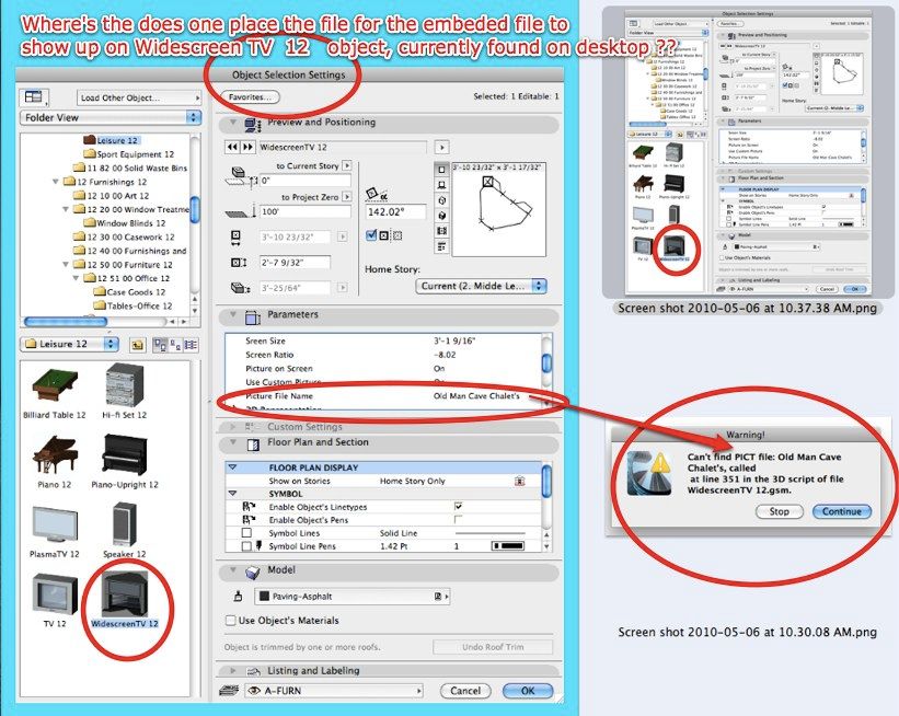

See the attached screenshot.
Unable to correctly place png file to be read by object for WidescreenTV 12 such that it will find the file and then display the image on the screen.
There must be a link with the object script and an outer location outside the actual object.
Thank you |:-)

Erika Epstein
Place the image file in the project library or if used on multiple projects the office file.
If you have the file open when you move the image to the library file don't forget to reload the library.

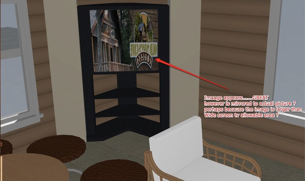

Erika:
Thank you for your help......see the pgn attached..
The image reversed itself, as shown.
I have clicked the mirror box off and the text has correctly reversed itself, not shown here. Please disregard question on pgn........
I have not tried one of these embedded images in years....this one is pretty easy.
Thanks again...... |: -)

Michael,
I can't reproduce the reverse image even making it several feet wide. I tried the same images on both mactel and pc with the same results. I have had people using the older macs mention that the images are reversed.
I sent you a picture to test on your machine.
