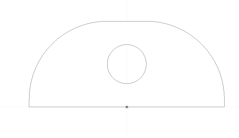

Yep, profile is drawn with a circle and fillets generated using the fillet tool. Screen shot of profile is attached.

The only other thing I can think of is if you used your magic wand to create the fill and how those settings are set up. If those settings are too high and you have the tracing method set to Linear Segments you may generate a fill like your first screenshot...but you would see this fill with it's segments.
It is interesting to hear you can actually snap to the intersections of the segments...this tells me the fill in the original profile has segments.
Maybe redraw the profile.

I did indeed create the fill with the magic wand tool, but I double-checked the fill and it appears to be correct (i.e. composed of curved segments where appropriate).
I also created a brand new custom profile and had the same problem. I've noticed that the problem additionally exists with profiles I didn't create (e.g. steel sections).
I am however able to draw, say, a slab or roof that is curved in plan and have it behave as one would expect.
This seems to suggest that the problem has something to do with the way in which the profile manager is converting profiles into objects...

Custom Profiles do get segmented in the model, see: Custom Profile, this is evident in small items. An alternative is to use the Slab Tool to create this piece, it will have better curve resolution.
David
David
