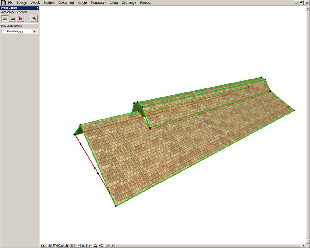

Hello,
I'm curious wether it would be possible to model a roof as seen on picture attached with one complex roof element. As you can see I used two to make this. Any idea how to make it ?
Archicad 16, Win 8.1
