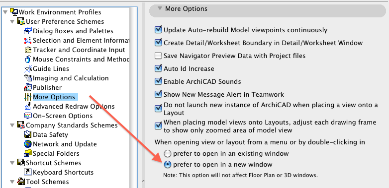

You have to set this option on first:
Options > Work Environment > More Options. Then set 'When opening view or layout from a menu or by double-clicking in Navigator:' to 'prefer to open in a new window'.

Hi Albert,
See attached WE preference to get details, sections, etc in separate windows.
Some people turn this off because they get a lot of extra windows open and it can bog things down. Graphisoft helped with that starting in 12 where there is now a 'close all background windows' command. And since you're on a Mac, you have Expose which makes viewing and choosing between all open ArchiCAD windows easy.

Oops - see it is already answered now (did not refresh this thread), but I'll leave this here for the screenshot.
