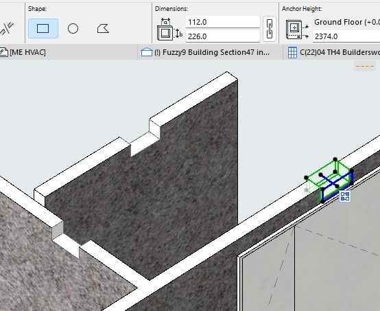

I've used the Opening tool to add holes for ductwork through my partitions. What is weird is that a lot of these Openings are behaving badly or weirdly as their width and height are swapped around and I can't find a reason why.
The screenshots show two openings one behaving correctly and the other with the weird behaviour namely when you enter the width the height changes and same if you enter the height the width changes.

Hmm may have found what is doing it. When I use the "Create Openings" palette the ressulting opening has the flipped width and height. Whereas when I just use the syringe tool and then place an Opening manually it works fine.
Would be nice if anyone else in AC28 gets the same result.

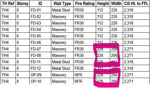

Graeme
Sorry I disagree, you can see in the screenshots below the objects measure 226mm in Plan whereas the preview of the misbehaving objects says it is 112mm. Also in the schedule I have made it gets it wrong too. It shows the length as the height and visa versa yet in 3d and 2d Plan view they are the correct width and height.

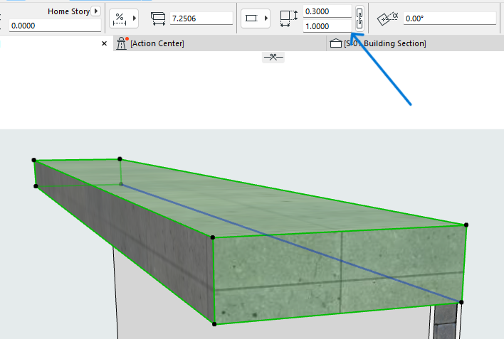

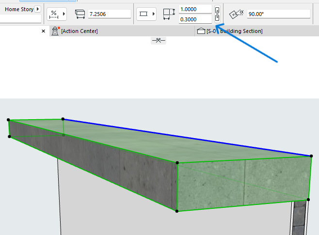

Turit
The opening can be rotated manually. Once rotated, it will not rotate back even after the properties are transferred.Turit_0-1779180129957.gif
Graeme
Thanks for the video.
To me that is a problem particularly if using fuse link dampers which need to be installed so gravity helps them operate.
If you create a schedule to which the Buyer purchases the dampers based on ArchiCAD's schedule where the width and height have got messed up as you show then the Damper will be ordered with the wrong orientation.

You're right, even beams have the same attitude when rotating.
Better, we should adjust their size numerically or graphically without using the rotating feature.
Don't know if it's a bug or not but thanks for informing us.
