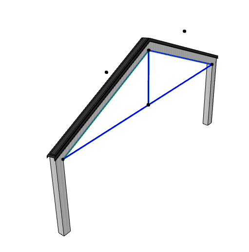

1. When you making copy of WALL with opening placed in it - openings are not being copied, but when you delete WALL where opening is deleted. I think openings should be connected with their parent objects same way windows/doors are connected with walls. In picture below diagonal openings are made in left wall, their were not copied to right side if tou not selecting all of them individually.

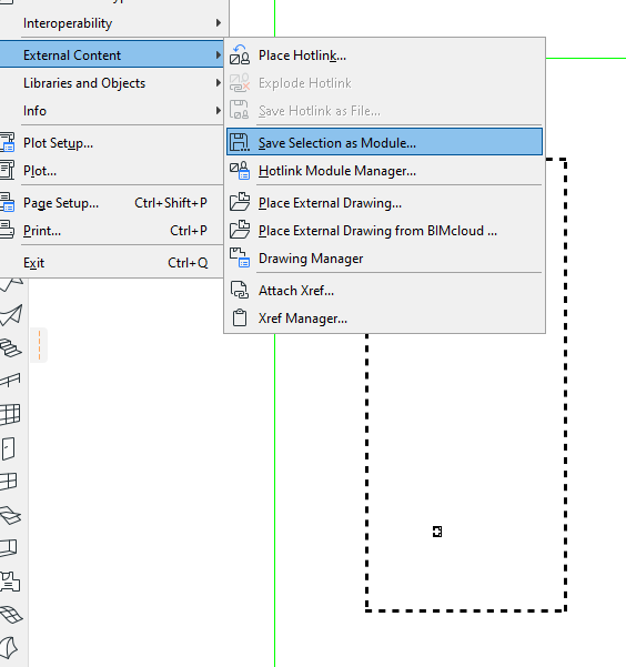

2A. Function I use:

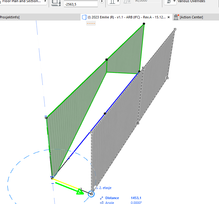

2B. How saving objects looks like in Source file with diagonal openings:

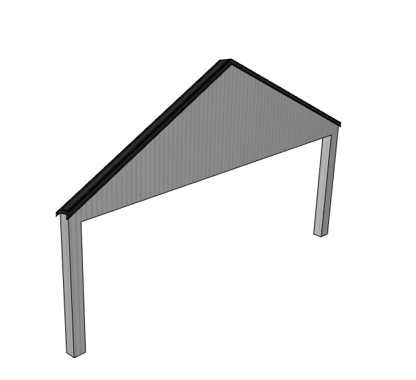

3C. Result - How object was saved in *.mod file without openings:
