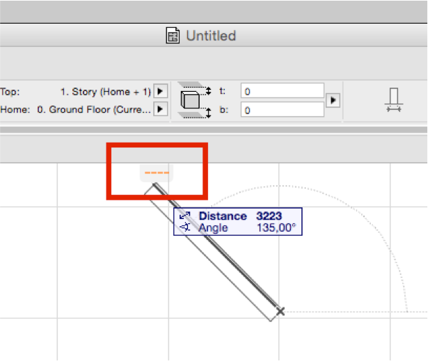

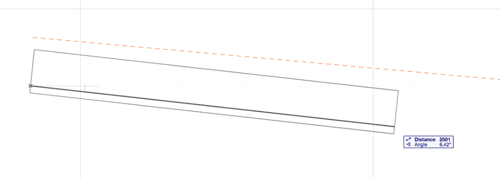

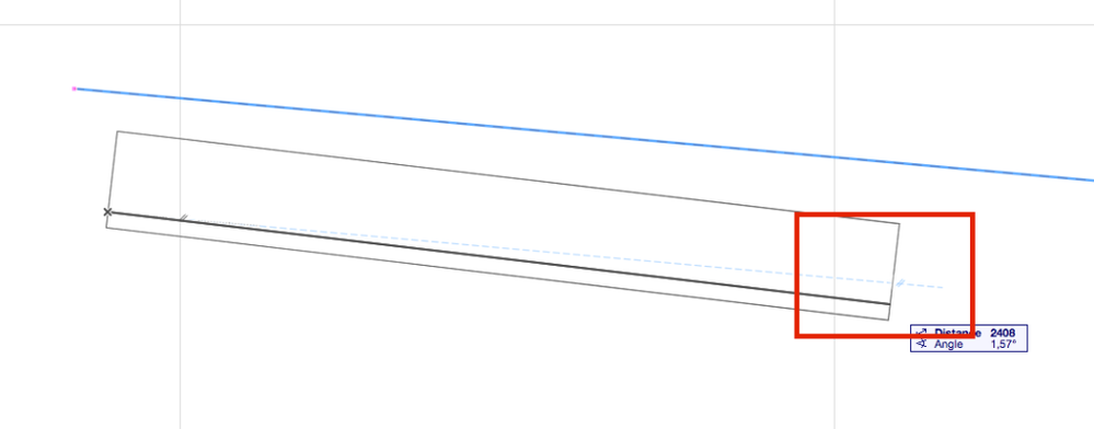

Parallel snap indicator doesn't appear with a Permanent Guide
Issue
The Snap Guide's parallel indicator doesn't appear when trying to draw a parallel to a Permanent Guide
Solution
Workaround: Apply a Snap Guide to the Permanent Guide. Now the parallel indicator will be visible
