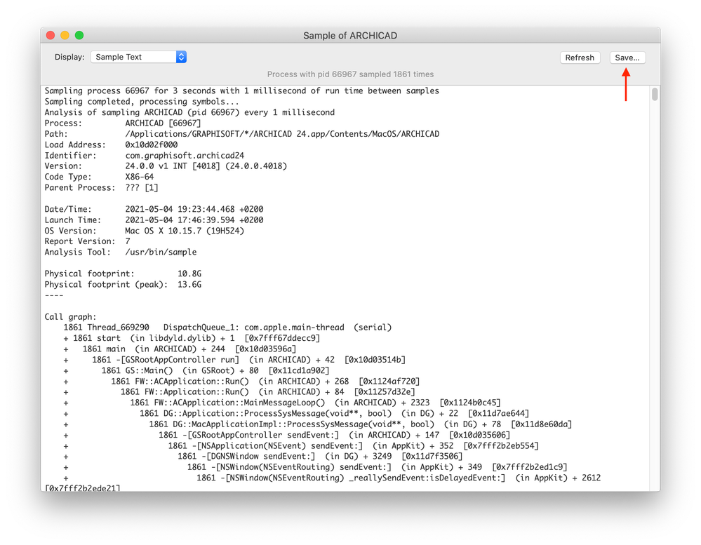

While Archicad is frozen, open the Activity Monitor, select the "ARCHICAD (Not Responding)" process, and click the Sample button:
This will take a few seconds sample from the running processes, and will display it in text format. Click Save... to save this in a .txt file. Please repeat the process and create at least 3-4 samples.

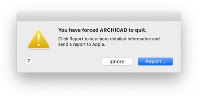

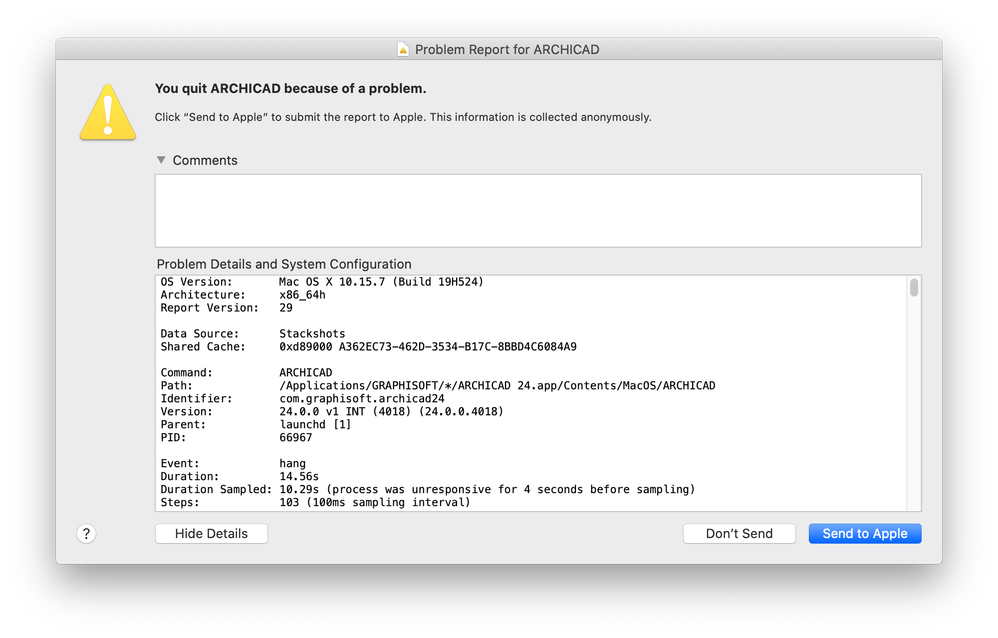

When you are finished with taking the samples, please force-quit Archicad. This should open up the Mac reporter (Note: this is not Archicad's GSReporter with the ladybug icon). If the Mac reporter does not appear then Archicad was not frozen from a technical point of view - it was just busy.
Click Report... then on the appearing window select the Problem Details and System Configuration tab. Copy all the text from here, and paste it into a text file.
