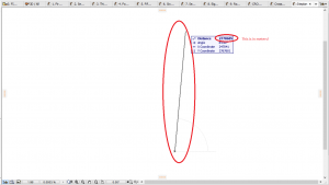

Typical visible signs
Click on the images to see them in their original sizes. This is what it looks like in 2D after "Fit in Window" with all elements shown when the project exhibits some far-from-origin issues:
This is what it looks like in 3D:

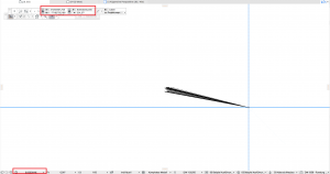

Affected versions: All Archicad versions | Severity: workaround applicable | ID: 215006 There are cases when the model itself is near the Origin, but Zooming causes phenomenon like on the following screen shot. This is the typical sign of a Worksheet with drawings Far from Origin.
In this very case, the solution - that we discussed above - can't fix the Far from Origin issue, because Archicad doesn't offset on the Worksheets if the floor plan doesn't need to be offset.
