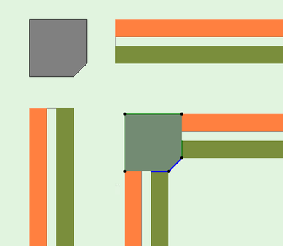

It doesn't seem to matter what I do with this small, quite simple section of wall, the polygon wall continually cuts completely through the other 'normal' walls.

I am not sure I am seeing the problem.
You have 2 walls with a gap at the corner.
Fill in the corner with a polygon wall.
Seems to work fine for me.
Lee Hankins
I thought it would be that simple but I cannot get it to heal at all. It just cuts both adjacent walls at 45º.

I see.
My reference lines for the main walls were on the outside.
Inside and I get what you are getting.

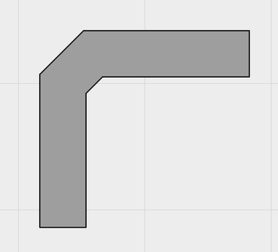

Lee, Barry: there is a trick for that! Do not directly draw a polygon wall, but a normal one.
You will end up with this:
After switching to polygon wall:
Now its just a matter of moving the outline, et voilá:
Done!
