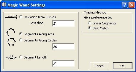

Does anyone know how ArchiCAD's profiler decides what resolution it will profile along a curved path?
Tools/Magic Wand Settings... a VERY useful settings dialogue box

Set the resol in the magic wand settings box per Woody's pic. Then make your object.
Changing the resol in the gdl script of an object made by profiler will not change how many segments were created.
How profiler makes the object is a multi-segmented tube. The number of segments is pre-determined by the magic wand settings.
The attached screen shot shows 3 different profiler objects made from the same 'C' shape . The left was set to 72, the middle 18 the right 8.
