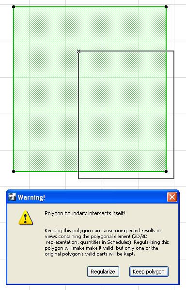

My question is: I have a slab drawn and I want to cut out part of it. I select the slab tool and select the slab. I find that I can start drawing in the middle of the slab or along an edge and I will cut a hole in the slab. But lets say I start in the center and go out to the edge of the slab. Now I have a hole in the slab but there is a paper thin line along the edge. I did not cut through the edge but left it there. Now I want to get rid of that thin line but I sometimes can and sometimes can't. I shift nodes and play with things and all of a sudden it is gone but I don't know why and I can't repeat it.
This same problem occurs when I use the magic wand with a slab and remove some of the slab. I am then stuck with thin lines that are left over. These might appear around construction lines I have use to form boarders. You don't realize it until you look at it in the three d view. Then it is quite obvious that it did not remove all you thought it would. This is in version 10
As a second part of this question, I can start my hole cutting in the middle of the slab or at an edge but I can not start the hole cutting at a node as the pet pallet opens and does not allow you to cut the hole. Thanks Doug

If you want your hole to be on the edge (ie not within the slab entirely) you're better off using the Subtract pet palette option (top right when selecting an edge to edit)
Laura Yanoviak
Select the icon with the minus sign (-) from the Pet Palette, "Subtract from Polygon", and you can cut the hole.

With this method, you can also go outside the boundaries of the slab, to ensure "no edge is left behind."

If you want to use the slab-inside-a-selected-slab technique the trick is not to finish you inside slab directly on the edge/corner of the selected slab.
Instead finish outside the selected slab and ArchiCAD will ask you if you want to regularize the polygon. This will make the subtraction as expected with (theoretically) no validity issues.
