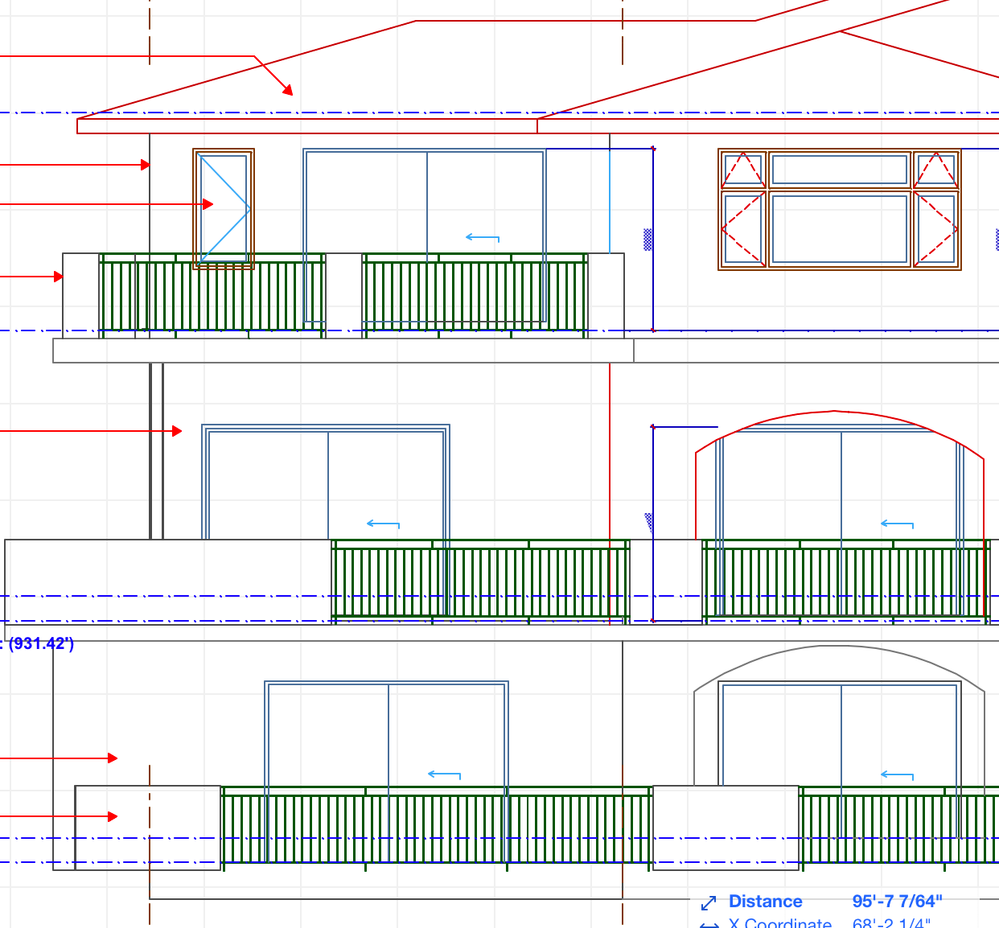

The elevations are showing the railing but not in my 3D...the filter is NEW. It is not showing up when selected to show in 3D. What am I missing?

Elevation showing the railing....

Check the layer is turned on (obvious I know!).
Check that you don't have objects turned off in the 3D filter options.
Try a renovation filter that does not hide or override anything.
