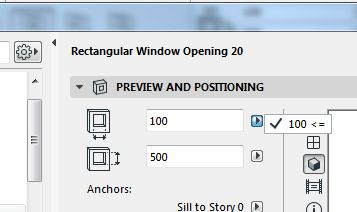

Is it by design that the Rectangular Window Opening 20 has a limit of 100mm? I would like to create a "ventilation slot" of 50mm in my wall but it won't let me have a width of less than 100mm.

Not sure why it is like this - all the openings seem to have different minimum values.
You can press the 'Empty Opening' button at the bottom left of the settings dialogue.
You will lose some of the parameter options but that probably doesn't matter if it is just a plain opening.
At least there will be no minimum size.
Ah - I didn't see that. Excellent - thank you very much!
You're welcome.
