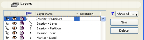

We have foud that the real issue with renovations is not layer control but things like junctions, priority intersections and similar issues that can completely stuff a drawing which contains new, demolished and old items. Archicad's inability to realise that 99% of users don't want gaps left in existing or new walls when the elements that previously joined at the point are removed or hidden causes inumerable, time consuming distractions. More intelligent defaults would help many users.
Sorry if i'm missing something but can't this be (mostly) solved using the Layer Intersection Priorities in your Layer Combinations? I know there can still be issues connecting skins of complex composite structures, but hidden elements should never be affecting visible elements if these Layer Intersections are set correctly.
Have you tried using the Intersection group number control in the Layer setting's dialogue box? With the help of this you should not have problems with visible construction elements getting gaps because of the hidden construction elements.
The best way to go about it is to have the demolished / removed construction layers with a different intersection number.
Agreed. I've been able to set up quite complex models, with layer combos using different intersection priorities, showing all of as-builts, demolition plans, and planned additions (in two or more optional variants), without any display or model issues.
The process may not be particulary user-friendly, but on the other hand these are complex issues to manage. And the setup I used wasn't too complicated, in principle just one layer combo for each final output.
Yes controlling the intersection priorities between the layers is time consuming at first, but crucial. Once you set up a template file for 'Renovations Projects' it makes life much easier.

Thank you all for your useful replies. The answer is, of couse, in setting the priorities properly and I'll have another go at it. However, Archicad's unintelligent defaults do cause lots of angst and impose the need to spend much time on housekeeping.

I agree that the defaults are not great ... everything is set to 1 and so cleans up with everything regardless of layer visibility. This changed in 8 (i think?) - prior to that intersection was visibility based so you did not have this problem. The new system is much more flexible, although that does bring complexity.
One more thing to read up on is the effect a hotlinks Master Layer intersection priority will have on how contained element layers interact with the host file ...
