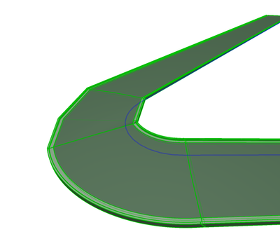

Sadly, the railing tool corrupts curved railing segments where not horizontal. Does not matter what resolution you give it in settings.

That said, I just discovered a workaround with the railing tool: start by placing only the curved segment of the path, including the slope. One placed, I found you can then extend the railing from each end of the curved section without the curved section corrupting.
