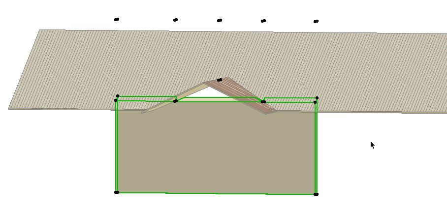

I manage to get one side of the wall and roof trim but I'm having problem on the other hip...i will posting 3 pictures....

You guys must be doing something different to Llian and I.
Select wall.
Right click.
Trim to roof using top of wall option.
Even if I select the roof planes I get the same result.

s2art wrote:
A single wall, with one "Trim to roof" operation.
did you do that with three or four roof planes?
I bet it makes the difference!
On the way out the door, so can't try but:
In Barry's example doesn't the wall that's being seoed in this situation have to go to top of ridge to work in one shot?

Thanks....yes, seo works!
