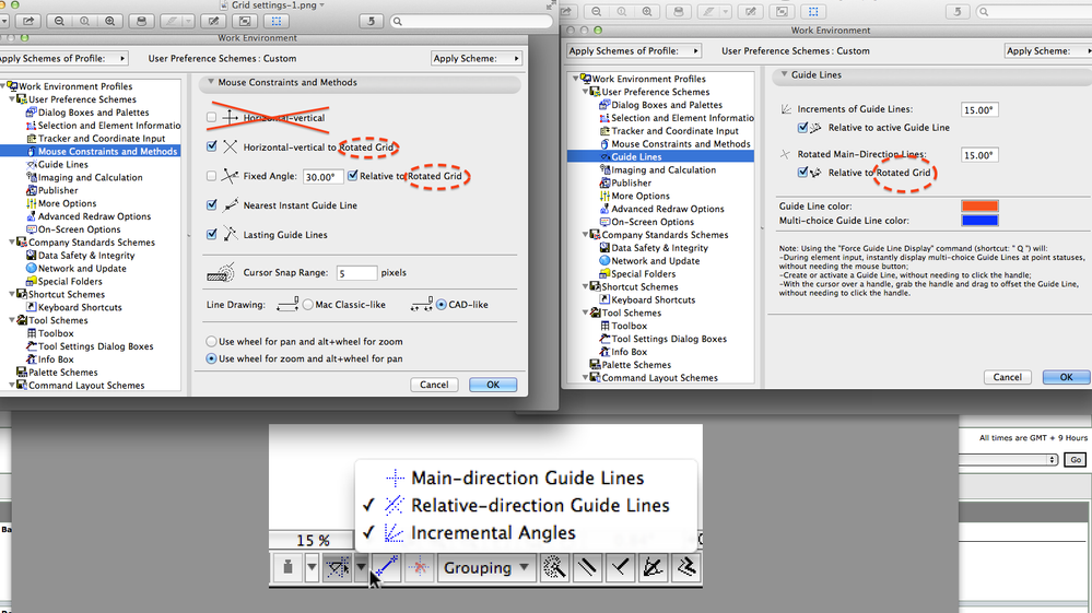

Is there a way I can stop ArchiCAD from snapping to non-rotated grid.
(I have a rotated grid that is about 1 degree off of the normal setting. My mouse constraints always want to snap to the non-rotated grid so I have to constantly watch to make sure things don't go askew.

Dontknow
Either you use your 'ortogonal grid' or your 'rotated grid'.
When you use your 'rotated grid' you shouldn't use mouse constraints because then you're drawing a staight line occording to your 'orthogonal grid'.
Architectural construction designer, draftsman, modeller
ArchiCAD 25.
Have a look in your Work Environment > Mouse Constraints and Methods.
Try turning off the Horizontal-Vertical lock.
And make sure Horizontal-Vertical to Rotated grid is on.
Thanks Barry / Dontknow
Thanks for your advice:
I found the following settings that work (see attached)
