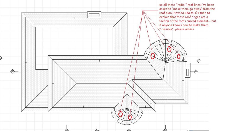

see attached.
basically been asked to make the "radial ridges" of the rounded roof portion disappear....how do I do that?

Lots of white lines.
Or cut out that section of the roof and use a SHELL in its place.
You can get a smooth curve with a shell.
Or if your roof is not going to change convert it to a MORPH and you can hide those edges.

Or possibly the best is to split the roof into single roof planes.
Select just the curved portion and convert that to morphs.
Union them together into one morph and then hide the ridges.
Or turn the roof layer off in plan and just draw lines exactly where you want them.

but if I morph the two roofs and "turn off (hidden edges)" the ridges...then ALL the roof ridges including the correct ones..will disappear...won't they?
i>u
Edgewater, FL!
SOFTWARE VERSION:
Archicad 22, Archicad 23
Windows7 -OS, MAC Maverick OS
With a morph you can select the individual edges so long as you use the alternate selection method (white selection arrow) - CTRL+SHIFT (CMD+SHIFT?) is the keyboard shortcut.
If you select the entire morph then yes all edges will be hidden - you will still see the perimeter in plan.
