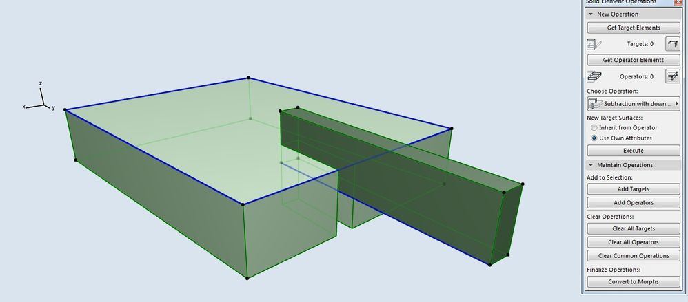

Please see attached screenshot. Clearly there is a solid element operations happening that I have performed, where the wall is doing an Subtraction with downward extrusion to the slab. However, for some reason that little blue box is not showing, the one where it lists out the various SEOs that pertain to that particular selected object.
Is it a feature that I've accidentally turned off?

It will appear when only 1 element is selected you have more than 1 selected currently.

Of course.....thank you!!
