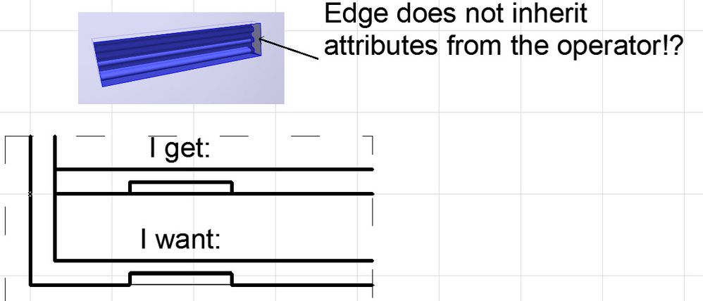

I guess the answer to this is a patch or redraw in a worksheet but I post it anyway. Maybe GS reads and put some effort in respresenting SEO i plan view.
The other thing though. Why doesn't the wall inherit the operator material in it's interior (the edge of the operator)?
/M
I just tried this with Wall (Target) and Slab (Operator), checking the the Inherit Attributes of Operator button and it worked. What is your Operator?
