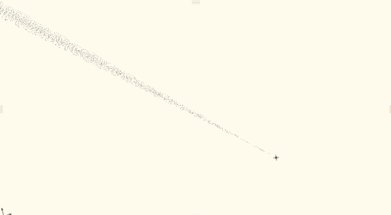

Hi all,
our model has mysterious points in 2d. It only shows if we zoom really out. It's not a point cloud (but looks like one), and with the selection tool i got that is a 2d tool,  specifically a Level Dimension Tool. If I delete every level dimension tool the points go away, but when I redo the dimensioning they appear again. What can we do with that?
AC 27 and 28 on Windows
1 Reply 1
Your model seems to be quite some distance from the project origin (bottom left of your image?).
Hard to tell from the image just how far, but this can cause some issues in Archicad.
Maybe this is one of them.
