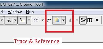

Copy the floor plan on the first floor and copy to second.
Even better, turn on the Trace Reference feature and you can actually see a reference image of the first floor that you can even snap to.
Trace & Reference is one of the top killer features in ArchiCAD.

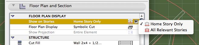

Another way is to define the visibility of elements on a given storey so that they might appear elsewhere as needed.
