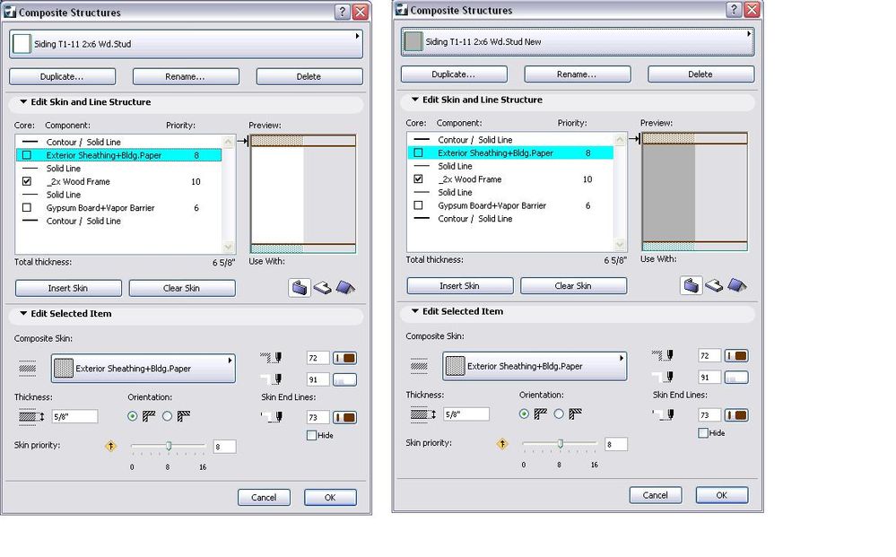

Looking for options on creating a composite with a shaded gray core.
Is it better to use a Solid Fill with a gray as the Cut Fill Pen (Which displays the Composite in the selection area in the dialog box with the solid black fill) or an Empty fill with a gray Cut Fill Background Pen (this option will show the Composite in the selection area of the composite dialog box as having a white fill even if is gray or any other color)?.

For me it comes down to consistency. If you have other composites that are just fill patterns, or composites that are fills over background fills, then it is nice to have similar settings across the board. If you are just using the one composite, then maybe it does not matter.

Here's one I'm working with at the moment. Must admit, I don't use composites very often. I think either way (solid fill or background) will work. The only implications I can think of would be with the Cut Fill v Drafting Fill settings in your Model View Options, and how you want to deal with those for various views (plans, sections etc.).

Another subtle difference is that if you use the same fill but just change the pen there is no separation line between the Fills. This may be what is desired or not. It seems that if the walls are in a line that there is no line regardless.
With the same fill pattern though, you do not get the shading distinction within the Composite selection DBX.
I am starting to lean towards the Solid fill (or make a Solid Fill 02 that is Gray, can you duplicate the Solid Fill?) with gray pen.

To answer your original question, I think you'll have the most flexibility using the Cut Fill Pen to determine the color of your poche. Stuart came the closest IMHO. If you use the Model View Option setting 'Cut Fill Patterns: Solid' to turn your walls into poche walls, the composite's Cut Fill Pen will be used to determine the color(s) of the poche, not the Cut Fill Background Pen.
Furthermore, I've had some client use dedicated pens for their cut fills, so that they can make their composites take on different effects (eg. colors) for different drawing types.
