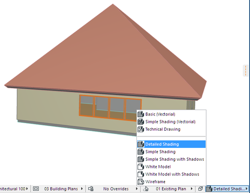

Shadows in 3D view
Is there a way to turn off the shadow effect when viewing the 3D model? I have been all over the AC help files and when I see something that looks like it might work l find that the popups shown are the same as AC25. There has to be instructions somewhere that says click here, select this and do this, I just can't find it.
Thanks in advance.

You mean the projected shadows? You can switch 3D Style of your view in the lower right dropdown menu. Just choose any other style that has no shadows
DetailedShading
