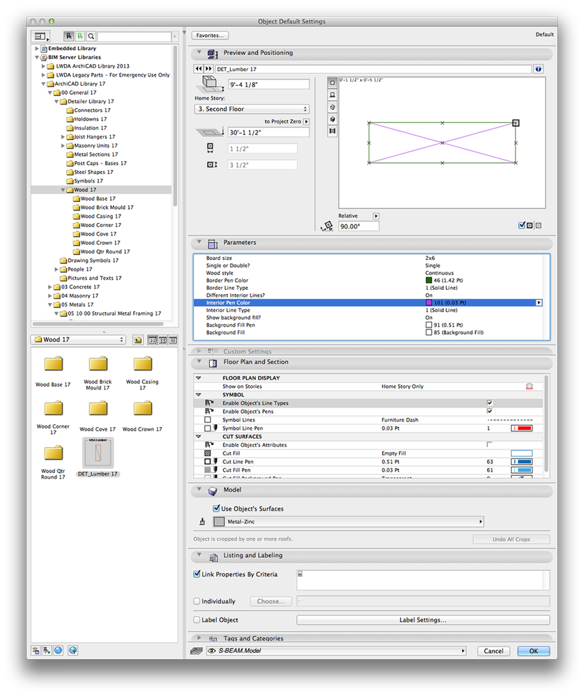

I typically use the 2d object for the 2x4 in my sections details and I do not model the framing of each stud.
Thanks so much, that's just what I was looking for Have a great day.
Anytime, same to you

You could also make your own complex profile.
Create a stud using opposing fills and apply it to beams, walls and columns. These may be a little easier to manipulate.

There is the simple object called "Joist" on the BIM components portal that acts as simple parametric lumber and has the X. Use this one a lot for quick modeling.
