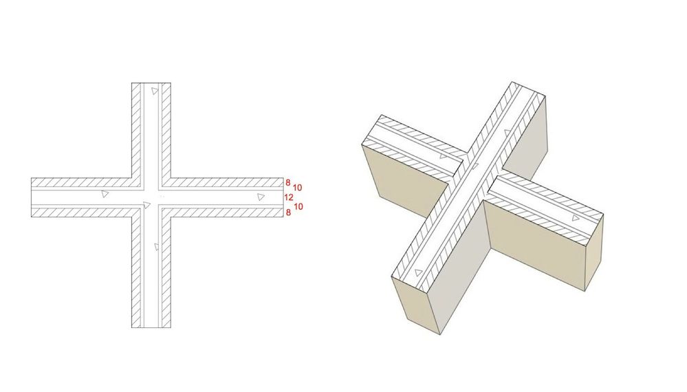

Do Skin Priorities work in 3D Documents? I can’t seem to get them to. The attachment below shows the same intersecting walls in Floor Plan and 3D Document windows.
The walls both have the same Wall Priority (the N-S wall was drawn second), and have “Enable Skin Priorities” checked. The appearance in the 3D Document window is as if “Enable Skin Priorities” is unchecked.
The Reference Guide suggests to me that Skin Priorities work in the 3D Document window (p 890, second subsection: “......and the 3D Document window,......”).

Dear Craig,
thanks for your observation.
At the moment this is a limitation in 3D Document. We are aware of this issue and the development of Skin Priority display in 3D Document is scheduled to be achieved in a further version of ArchiCAD.
