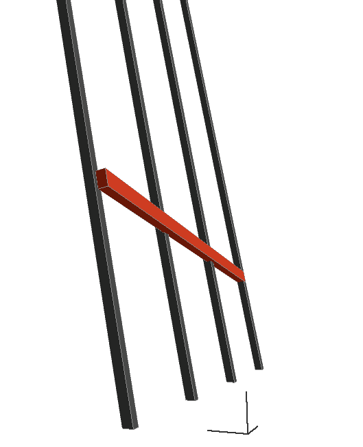

Hello,
I am trying to slant a beam while maintaining its co-plainer relationship to the slanted/leaning columns.
every time I try to slant the beam, It will go out off plane.
I have attached some image to help explain what I am trying to achieve.

below is an image that shows how the beam goes out of plane when slanted
I am trying a few things but I still can't get a perfect result.
I am really struggling with this. I really hope someone can help me with this. I have posted another image that shows how my beams are out of plane.
kinda getting there. I have been messing around with a number of approaches. I think the 3D look good, but my section clearly shows that the diagonals are not on the same plane.
any suggestions or ideas how to work this out?

Hi Djordie,
I have tried strussmaker, but wasn't quite successful.
I am trying to build a diagonally braced frame for a high-rise structure. the frame is to be tapering and this tapper is what is causing the problem.
Project is in Kuwait, not too far from Dubai.
I will spend some time learning how to create my bracing members in GDL.
thanks for your suggestion

habiatuq wrote:
Hi Djordie,
Habi
Take a look at OBJECTiVE - it has been designed to make this kind of thing easy: http://www.encina.co.uk/objective.html

Ralph thank your for the reference.
I have looked at the add-on and it sure looks promising.
Rotating and object in 3D and the workplanes are exactly what I need to build my frame.
thanks a lo
Habi
