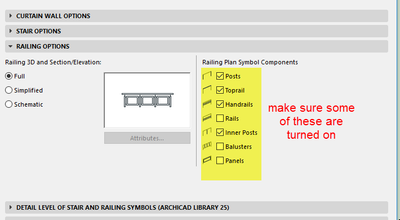

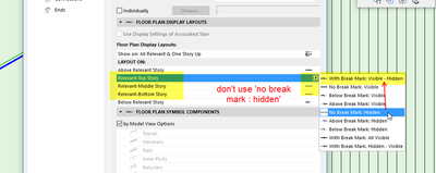

2022-05-16 10:18 PM
Hey, thank you! Do you know any reason as to why it wouldn’t show on the floor plan? Mine doesn’t, there are no graphic overrides, and I have tried arranging it to be on top.
2022-05-17 03:35 AM
If you mean why the railing is not showing in plan, I can think of 2 reasons that it might be.
One is the Model View options.
The other is the Floor Plan Display in the railing settings.
2022-05-17 07:49 PM
Thank you, the latter one worked:)
