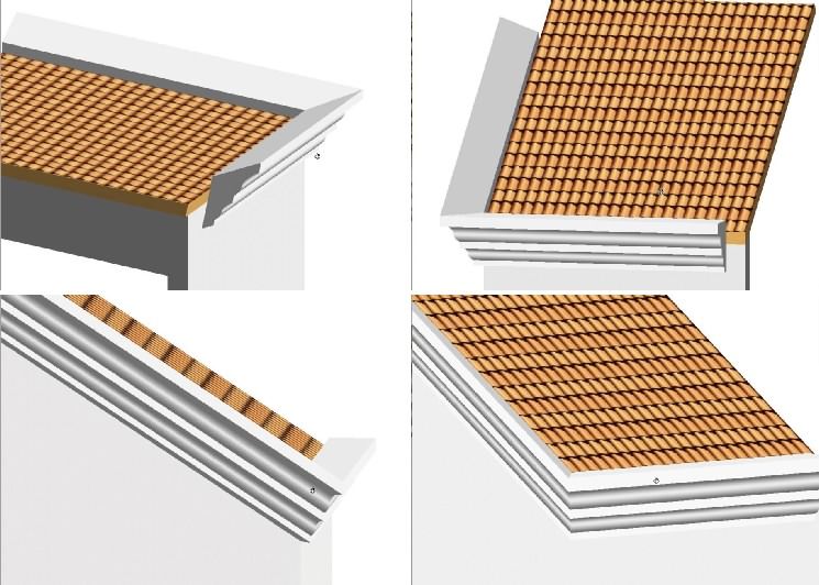

I finally got around to experimenting with complex profiles
to model a raking molding mitered to a eave molding.
Using the construction method for drawing the profile
of a raking molding described in Architectural Graphic Standards
classical orders and detail. It worked out quite well. see attached.
Peter Devlin

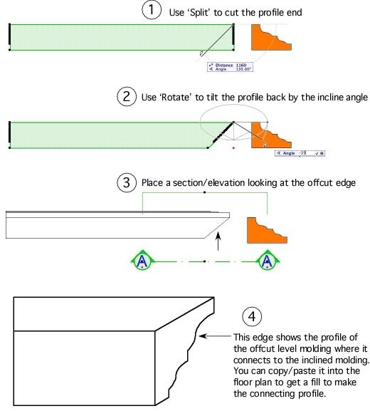

I'm not sure if this is the method Joseph was suggesting, but you can make the connecting profile really quickly by the following steps (see attached image):
  • 1) Use the Split tool to cut the connecting edge of the molding on the level
    2) Use the Rotate tool to tilt the profile back by the angle of the connecting molding.
    3) Place a section/elevation looking at the exposed end of the molding.
    4) What you see in the section is what the profile of the level molding will look like along the path of the molding on the incline. You can get a Fill to make a new profile from this by copy/pasting it to the floor plan.
This could be added as an automatic feature of OBJECTiVE if enough people want it - anyone care to comment on whether this is a common problem?

Hi Peter,
What I've done would only match condition 1 if I hadn't rotated the eaves molding back by the angle of the raked molding. What I'm doing is placing my viewpoint in the same plane as the roof, i.e. I can see what the connecting profile looks like by looking along the line of the raking molding.
Ralph Wessel BArch

Peter wrote:
Please show me what the eave and rake and the miter look like.
Peter,
I've elevated the raking molding and eaves, hopefully to clarify further. Was this what you meant?
BTW - I just realised why you think this might match your condition 1. My step 2 is only a temporary construct to generate the required profile. The eaves molding in the completed model is still upright, i.e. not rotated. Make sense?
