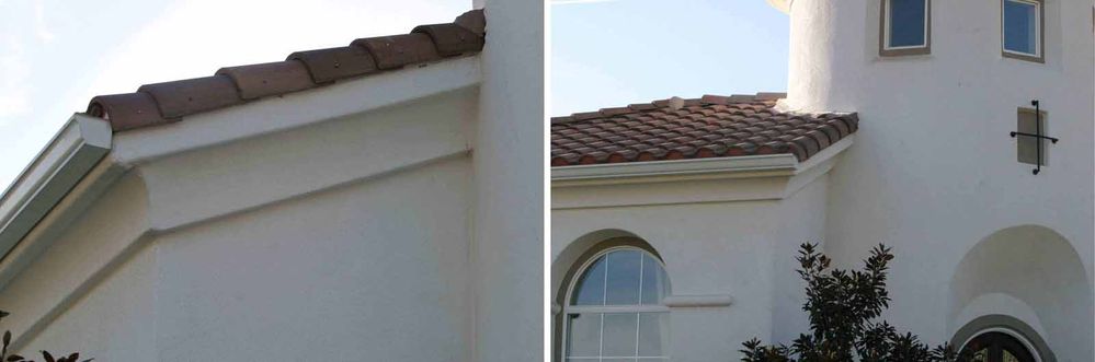

I seem to have forgotten how to make a sloping profile. Can someone please advise me before I kill myself.

From your explanation, I now understand the issue of joining molding when slopes collide. The intricate profile sections shown in your graphic clearly illustrate this. AFA making details work in the field; to some extent the carpenters use some level of artistic license, and maybe cement plaster hides their sins.
In the attached photos, I think the sloping or rake cornice must be
taller in dimension for the bottom to align with that of the eave cornice.
Thanks again for the great explanations.

I finally got around to experimenting with complex profiles
to model a raking molding mitered to a eave molding.
Using the construction method for drawing the profile
of a raking molding described in Architectural Graphic Standards
classical orders and detail. It worked out quite well. see attached.

Peter,
This method is call Projection.
Both the moldings share a common cutting plane. For proper connection, the projection of both profiles onto the cutting plane must be identical.
