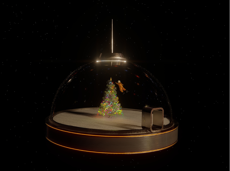

Firstly, I started with the dome itself, this is the easy part.
I knew I wanted to have a big Christmas tree in the middle, around 5 meters, enough space for some decorations and for a small group of visitors. Thus I ended up with a dome that is 8m in radius.

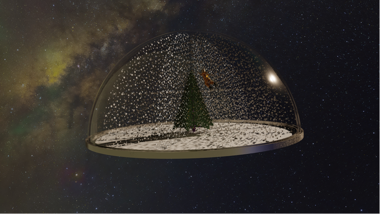

I wanted to have snowfall inside, and it had to look decent. Using particles was out of question as this would make the model too complex. The precipitation effect in Lumion could not generate snow only inside of the dome. So the best solution was to use some sort of polygon inside the dome, where a texture of snow would be applied.
Here you can see the very first dome. Inside I put a simple tree and cosmonaut for scale.

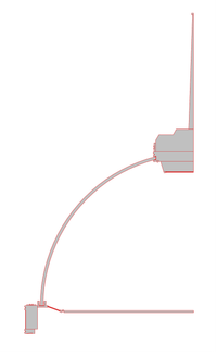

It was modeled with the Profile manager tool, one of the most powerful modeling tools inside Archicad and I use it regularly in almost all of my projects.
This is the profile I started with. It includes not only the glass dome, but also a metal frame and the floor. From now on, I will add elements to this profile and my model will grow and change automatically. This is the power of the complex profiles!
Here you can see how I applied the profiles using the wall tool:

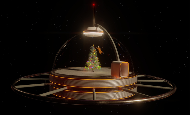

A rotating ring around the dome was created with simple round beams. I could use round complex profile and the wall tool, but there is no need. I also added a curved structure that connects the top module with the base of the globe. I made this with the beam tool, since I knew I will make it more complex and I can easily do that by simply changing the profile of the beam.
I wasn’t satisfied with the ring, it looked too simple and unreliable. I enlarged the diameter of the ring, to better fit the proportions of the dome. It also got a more complex spaceframe - that not only makes it look more durable, but also resembles a stylized snowflake, which fits the Christmas theme of the project. Again all modeled with the beam tool. Finally, to make this space station look more ‘’balanced’’ I mirrored a second dome on the bottom.

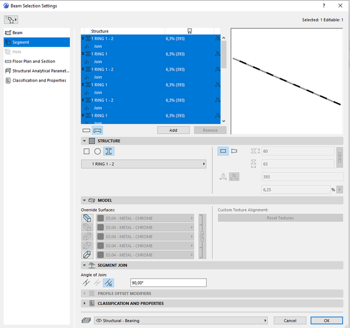

For the peripheral beam, I used two complex profiles applied with segmented beam. The two profiles are basically the same, the only difference is that one is white and the other is black.
Here you can see how I used a segmented beam to combine the two profiles:
The idea behind this black and white ring is not just aesthetical. This way observers can easily notice the rotation of the ring from all angles, even if the light sources are not working.

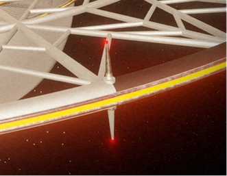

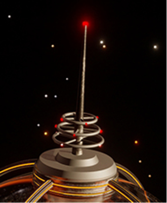

For the next step the antennas some refinement by adding rings and lights around them, all done with the beam tool.

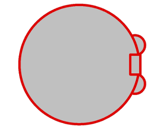

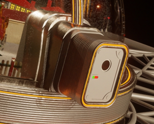

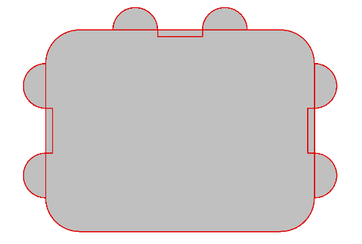

The entrance was modeled using a combination of several complex profiles.
I modeled the door with the slab tool, then converted it to morph, rotated it and placed it inside the opening.

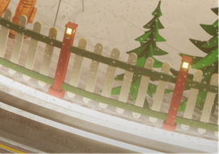

The railing inside was created with the railing tool and some custom elements of my own.

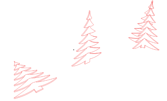

The trees and houses inside the dome were created in a similar manner. I modeled them on the floorplan view with the slab tool, then convert them to Morph and rotate them.
