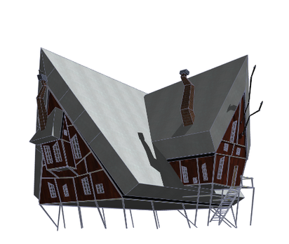

The house is built with the basic tools of Archicad: walls, roofs, columns and beams. All walls and beams are slanted and not so well drawn as to give it a clumsy look. The snow is also modelled and is a copy of the underlying structure with a greater thickness.

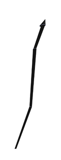

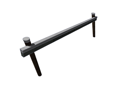

The fence with the snow on it consists of different columns and beams. The snow may have only one pixel in the final image but it still provides some additional detail.

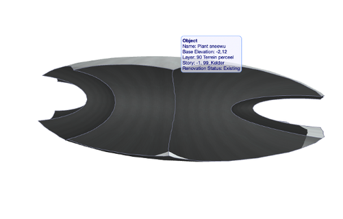

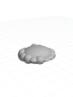

Ground and ice floes
This object appears several times in the model: both to create the hilly terrain and to fill up the background.
The shape is a flattened sphere from which spheres of different size and shape are cut.

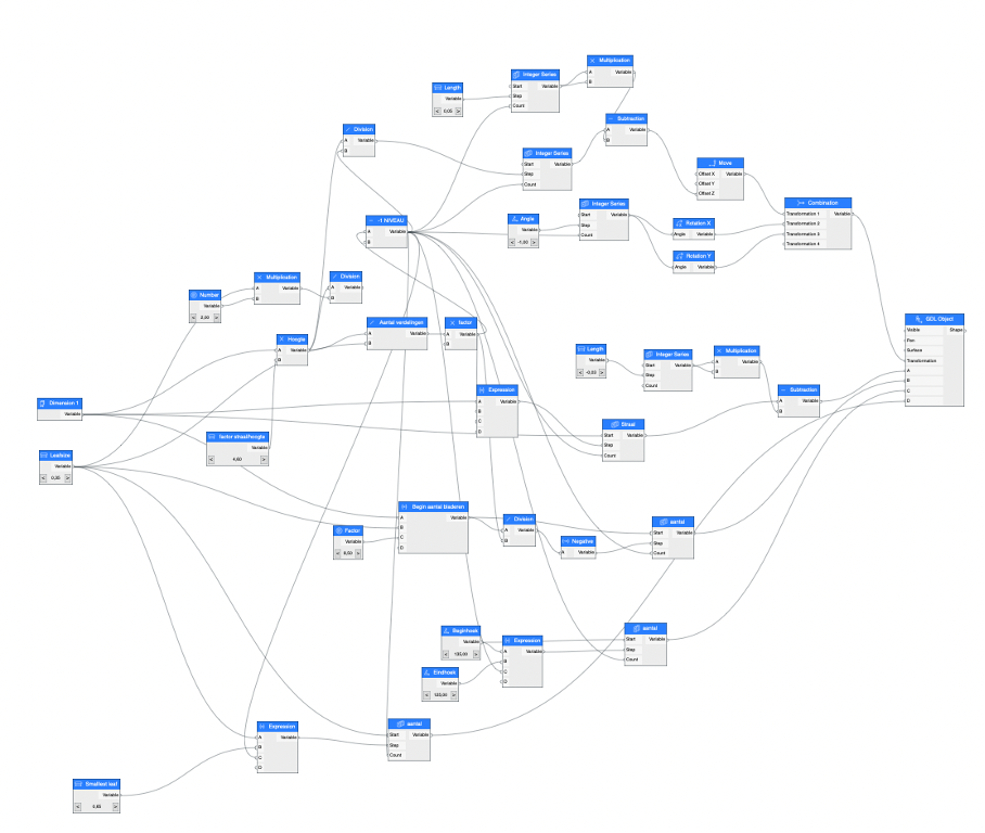

The schematic of the ice floesThe schematic of the ice floes
In blue, the larger sphere where you can adjust the diameter and height; in green, the various spheres around it, their position being determined by the radius of the larger sphere.  In pink the settings for flattening the whole object and in yellow the rotation of the final object.

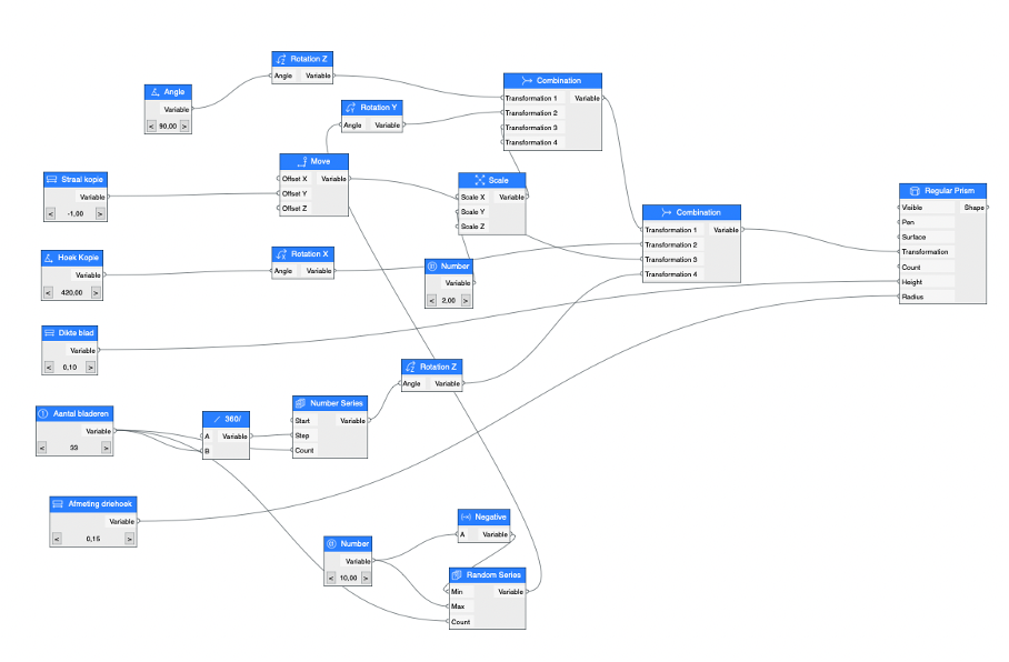

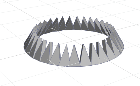

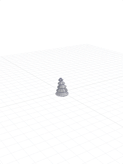

The trees are the most complex element.  For this I made two param- o objects.  The first is a ring of triangles that will form the leaves.
This shape has 4 parameters that are used in the final param-o object: the radius, the rotation, the number of leaves and the size of the leaves.
The schematic of this ringThe schematic of this ring

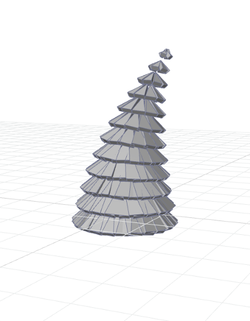

The final object makes copies of the ring and adjusts the 4 parameters. Thus, the ring and leaves become smaller towards the top and the number of leaves decreases.
The diagram of the entire treeThe diagram of the entire tree

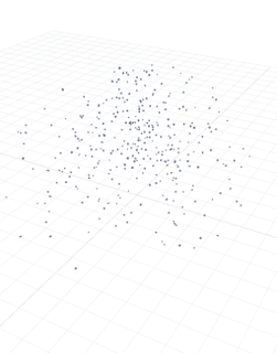

Snow

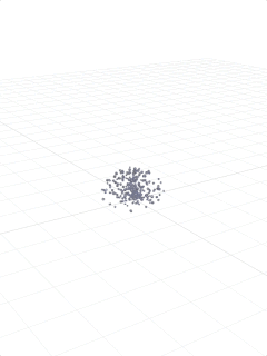

The snow is also a param-o object based on a simple prism shape (reduce polycount). Which is copied randomly into the hemisphere.
The diagram of the snowThe diagram of the snow
  • In yellow: the random dimensions of the snow with values between 0.02 and 0.04;
  • In blue: the displacement over an arbitrary distance from the centre;
  • In green: the rotation over an arbitrary angle with the centre as the rotation point. The y-rotation is limited from -180 to 0 so that there are snowflakes only in the upper part of the sphere.

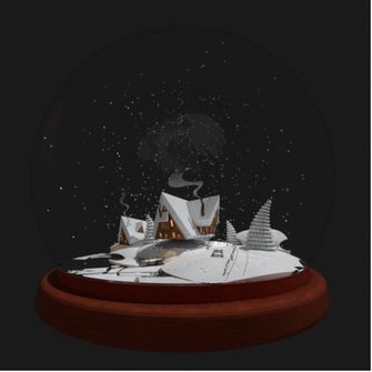

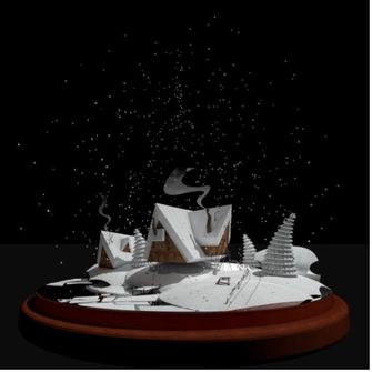

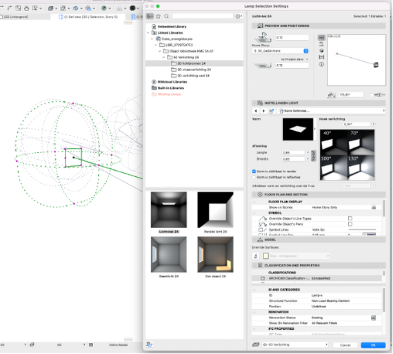

The lamps in the interior give the image more detail and warmth.
No interior lightsNo interior lights With interior lightsWith interior lights
All lamps are light surfaces that are directed at the snow from the inside and cast light on it, providing shade.

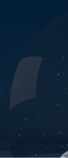

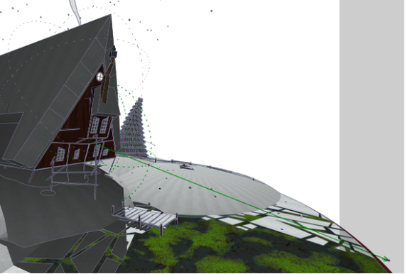

Because the glass of the snowglobe was not very visible, I also placed a lamp that is visible in the reflection of the snowglobe.

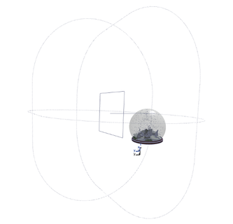

Camera settings

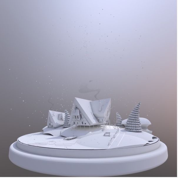

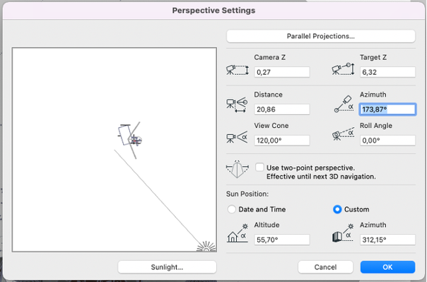

I used a wide angle lens to get more into the sphere and to increase the perspective. The disadvantage of this was that the underside of the snowglobe looked very thick, so I adjusted this later.
White model renderWhite model render

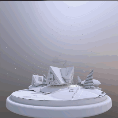

I tried a lot of settings to get to the final result.  The first tests were with real clouds, but these were too distracting.  In the end, I chose a background with a simple gradient of dark colours.

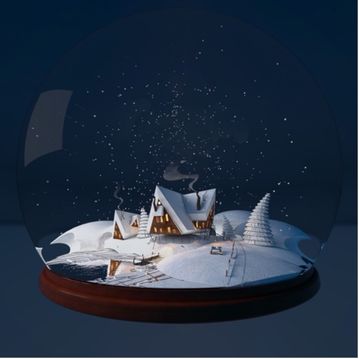

Final result:
