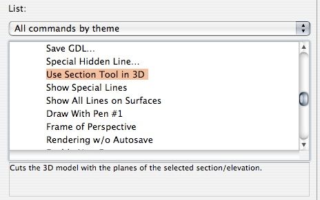

__archiben
gergazi wrote:
Does anyone or Graphisoft has some document for "how to use " them I could not find anything in Archicadwiki.
they are hidden and 'undocumented' features for a reason - they may not work in all situations (ha!); they may be unstable; they may be commands that decrease the performance drastically; etc.... and you should use them at your own risk. try searching the forum here, you will see more discussions surrounding the use and abuse of special menu commands.
to give you some indication of what they do, you could look at the 'help' string attached to each command. if you select each command in turn in the menu scheme of the work environment you will see a brief description of what each is supposed to do . . .
~/archiben
