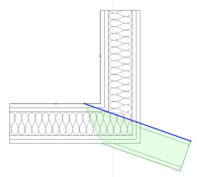

I've searched and found a number of old responses to similar questions, and various suggestions have been made, with varying results - all unsatisfactory and problematic in some way or another, unless I'm missing something obvious!
What I want to achieve is thick walls with splayed reveals on the external face, but not the internal face.

I don't think you will win with this one with the reference lines on the outside.
Because you are wanting the external walls to trim at a right angle (which they do).
You angles wall is passing trough one wall (not touching its reference line so it will not trim) but is touching the ref line of the other wall so it is trimming to that - hence the gap.

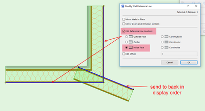

The best I can do is to move the ref lines of the outside walls to the inside - you can select all exterior walls and do it in one step.
Then continue the angled wall past and then sending to the back in display order.
Just stop the angled wall inside the outer edge of the external wall otherwise you will see a line in elevation/3D.
My walls have transparent fill backgrounds so display order is not showing here.

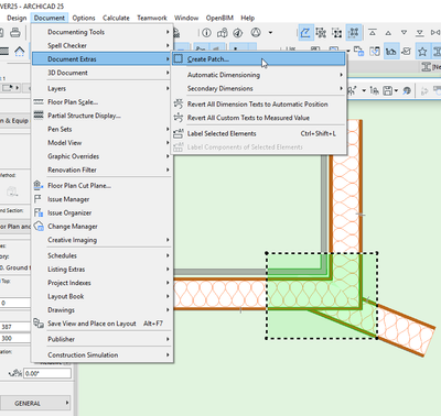

The first option above should work but if it doesn't then the only sure fire way I know that will work is to place a marquee, and create a patch.
You then select the patch (object) it places, open the object for editing, go to the 2D symbol windows and edit to appear how you want it.
Save the object and it is done.
It won't affect the 3D, so you will still probably have to move the ref lines inside and adjust the angle wall so it is not touching the outside, but covers the corner (as in my top image).

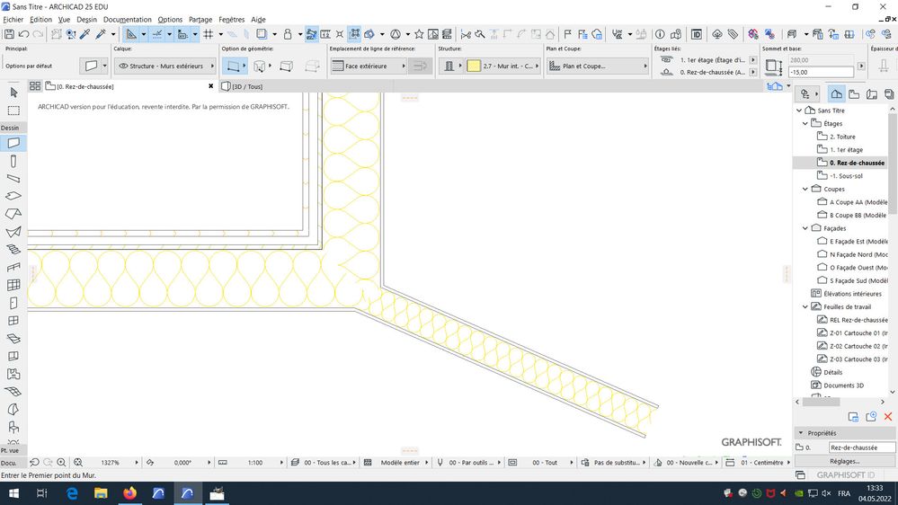

It's possible to achive, the reference lignes of the three walls have to join at the same point.(see attatch). You'l have to offset the reference ligne of the interior wall.

If the reference ligne of the 2 exterior walls is place on the inside face the geometry allows it in @Rene Pahlavan 's case. He can easily do it with Barry Kelly's tip.

I feared that selecting all the exterior walls and picking the inside ref line would displace all my exterior walls and I would have to move them all back manually and intersect the corners (I have done this before to get things right). However, I did not know about the Modify Wall Reference options (found under Edit - Reference Line and Plane ). This did the trick - reference lines moved without affecting the position of the walls.

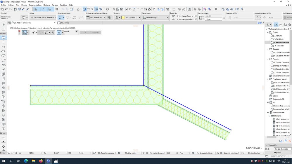

It's allways possible, even if you want to keep the reference ligne of the exterior walls to the exterior face as you can set the reference ligne anywhere inside the wall base if offset is positive or outside the wall base if offset is negative (see attatch).
