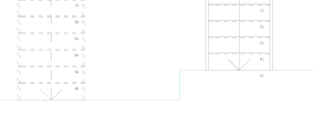

Hello everyone,
Can someone please help me understand why one staircase numbers the landing and why one doesn't? I wish to have them all numbering the landing as that will count for a riser also.

Probably the stair on the left has the last step at the landing level so it the landing it self. The stair on the right has the last step lower than landing level ...
Is it?
Is it?
In this drawing, yes. But if the stair on the left was exactly like the one on the right, it would not number the landing, unless I show the last step at landing level. Do you see what I mean?
For 2d drawing the stair on the right is the correct representation and that is what I would like to achieve with the one on the left.
