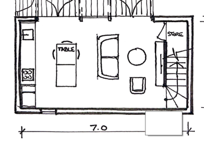

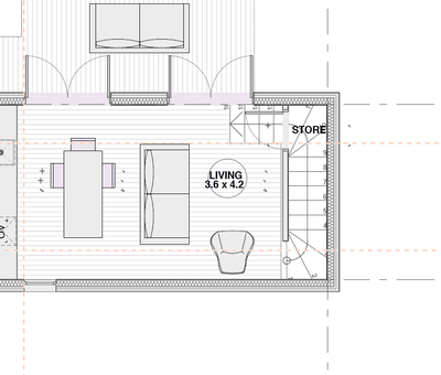

I would like to know how to customise staircases in archicad.
My stair in the ground floor looks like this...
I want it to look like this...
Thanks....

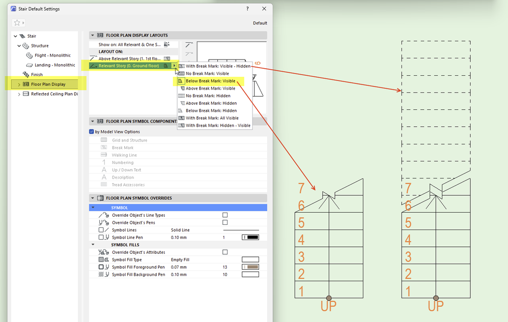

Go to the Floor Plan Display and set it to how you want it to appear on each storey.

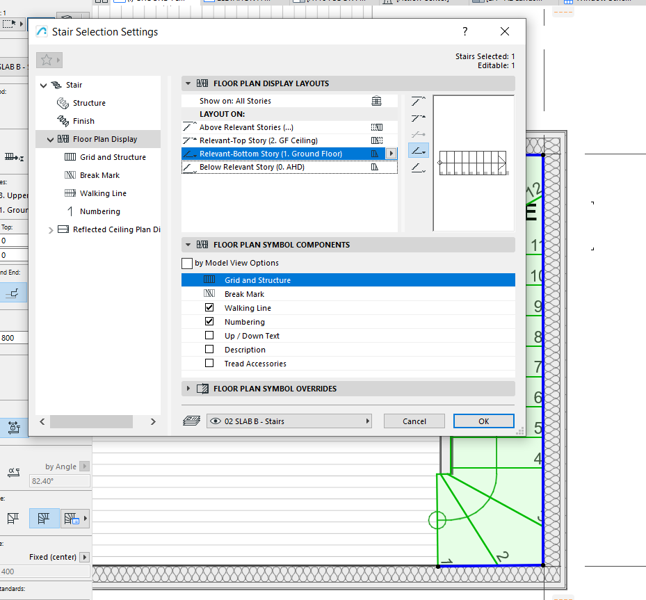

clauds1223
Here's what the settings dialogue looks like...
The settings look correct, but it seems you have no break mark.
The hidden/visible options only work when there is a break mark.
