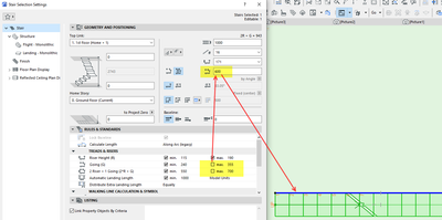

Hey guys. I need to create a flight of staircase with a tread of 600mm, how can I achieve this?

Turn off the rules that limit the tread lengths and tread/riser ratios.
