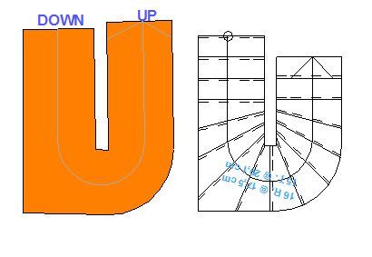

Ernest Atanasiu
Just asking
Is there a product (or workaround) to make a stair with landing and flights with non parallel sides. I need to make this kind of stair and can't use the "create stair using selection" method.
thank you
arch. ernest atanasiu

uisanata wrote:
Just asking
thank you
Your travel line should not be curved in the first flight. Try straight to the landing, straight, then curve.
It should work.

Ernest Atanasiu
I realized after posting the image that I should have drawn all the tread lines to explain what I want to make.
It'a a U-return winder stair. Maybe this will clarify.
I tried like you said and it's not working.
May i post the file somewhere, to play with it?
thank you
