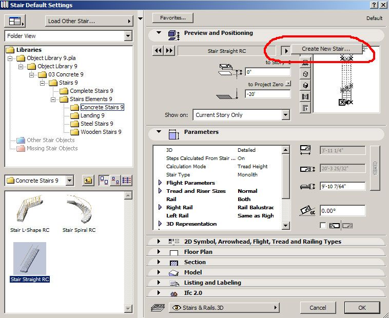

Is there a way to turn of the widened landing in the wooden straight run stair under stair elements? Is there a way to control the second floor image of the stair in complete stairs so that it does no appear in it's full length version on the second floor? If not am I correct that I need to use the concrete stair to get both features her-fore mentioned to work on my stair?

It sounds like you need to explore creating your own new stair to solve these problems. Please see the attached image to see where to do this.
