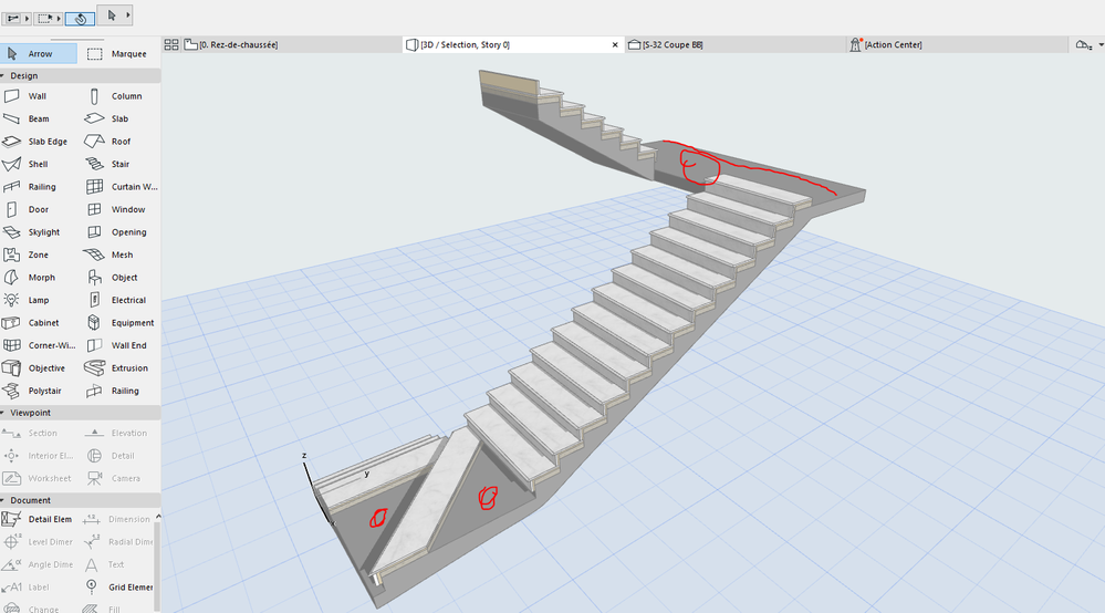

Hello everyone,
I have a problem with the Stair tool when I try to apply a profiled Tread as a finish. The result is ok for the flight tread and riser, but the profile gets applied on the land for the same width (attached). I have already activated the Width Sketch option for the profile, but nothing happens !
In this case, I think that I will have to model the landings individually unless there is a hidden trick to solve this.
What do you suggest ?

you need to create a different profile for the landing
In the end what is your Objective?

Thank you for the reply.
The other landing profile must be just created keeping the same dimensions ? or it must be different? because the landing shape in irregular, I wonder how would the profile form be ?
