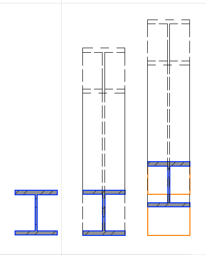

I have a problem with a steel frame object.
I have added the "Double Slope 12" object from the standard library. The problem is that I can't see the profile of the frame-leg on the floor plan.
What can I do to resolve this problem?
I have attached a picture of what I experience, to the left, and what I want it to show, to the right. (The picture to the the right has been edited and is not a result from AC)
Thanks for any answers or comments!

It looks like this object has not been scripted to show the Floor Plan Cut Plane, so it will not show the leg cut you describe. One work around is under Parameters > 2D Representation > 2D: Detailed to show the beam outlines, then trace this with a fill.
David
www.davidmaudlin.com
Digital Architecture

‎2008-10-14 03:34 AM
Left hand column is vertical
Centre column at 80degrees to vertical, projected with overhead, but base elevation is 0 and cut plane is 1100mm, it shows cut at base.
Right hand column at 80 degrees, projected with overhead, base elevation -1000 with cut plane still at 1100mm. This is what I was expecting to see on central column.

whatever wrote:Short of building the cutplane sensitivity in the object, which I have been asking for since it has appeared, there is no correct solution.
well actually it is not an option for that object , a workaround ( that I haven't tried my self , not sure if practical even ) . to consider 3D documentation for those elements and combine it with the floor plan ( without the steel frame ) in the layouts . ahh ...even saying that seems taking so long !!
What I normally do (and ALL of our buildings are steel structure ... many of them logistics, factories etc) is use the columns and the beams separately. That way you can control the display perfectly. Plus, since 11, you can define the cutplanes on the top and the bottom, ends of the beams, even overlap them as needed, quite enough for the architectural part and export to IFC enabled structural analysis software, and the change of heights for the gable walls (more columns than in the interior) happens graphically. Z profiles work for purlins - don't be afraid to use them, they help immensely for correct sections and exact positioning of the openings in the cladding - there you will probably need C channels. Recommended.
The custom profile column approach is good, but when the structure is calculated, more often than not the sizes have to be correct; so it is much easier to Find&Select and go the new profile size than redefine all the profiles. Essentially, display wise, it is the same as using the objects, without the flexibility of changing the size in one go.
I vote for the separate column and beam approach.
Alternatively, create custom profiles for all the BS etc sizes ... do I hear an AAARGH? ... yes, I thought so
ArchiCAD since 4.55 ... 1995
