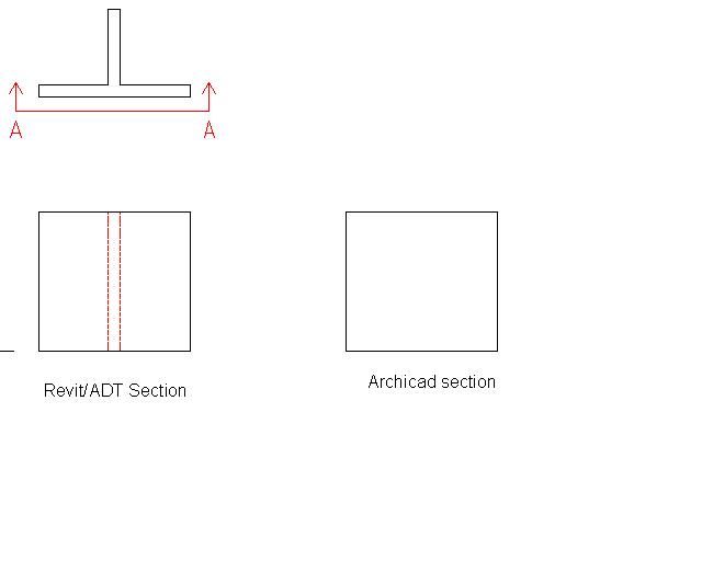

I am trying to make the structural drawings for a project in the same Archicad model that the Architect is using. We thought it would save time and improve coordination.
Generally this has gone well but I have hit one problem that we cannot solve. In structural drawings, the sections need to show adjoining walls behind the front wall with a dashed line, as shown in the attachment.
The only answer I have found so far is to draw the hidden lines. This looks OK on the drawings but is time consuming, and if things move, the lines must be updated manually.
Does anyone know if it is possible to get Archicad to show hidden lines in sections?

The best I can think of off the top of my head would be to cut another (zero depth) section through the walls behind and overlay the two in the layout. I can't see anyway to make the lines dashed automatically though - they could be shown as grey by changing the pens.
This is exactly what I was going to suggest...except that the dashing is possible by a trick that I use for a great many areas of drawings: the use of a masking diagonal fill that uses a fat white pen for the line and a transparent background.
Create a view of the 'walls behind' section that has the masking fill on top, then place both views on your layout sheet, aligned exactly to one another via either a common elemenet or a hotspot (placed with hotspot tool) at a known common point.
In AC 11, a nice thing is that you can use ths 'wall behind' section as the ghost when working on the foreground section...and use the 'switch active with reference' button to flip back and forth between them, should any changes be required to one or the other.
