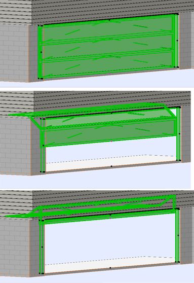

So, has anyone figured out how to make garage doors open correctly in 3D, cause mine open straight up and shoot through ceilings etc. and I think it is pretty lame-o.

Which one of the six standard AC garage doors are you using, and screen shot of setting that is making them shoot straight up?
Bier
I was about to promote Door and Window builder again, but see that the lower panel of a sectional door remains vertical when open beyond a certain point.
At least it has separate settings for opening in Section or in 3D.
Here are my door issues.
