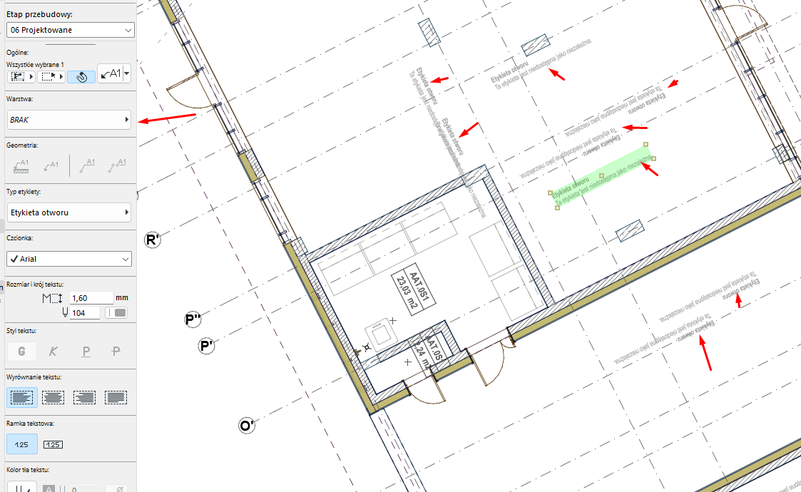

I'm having an issue with labels being exported to .mod file and then back to the host, even though they don't exist in the exported view.
As you can see, it's reimported as the unlinked labels blocked by the hotlink and placed on the missing layer, so that they can't be hidden. I've found a stupid sollution, which is to use graphics overrides, find unlinked labels and paint them white, but that's very annoying because those labels are being printed on layouts and it looks very unprofessional.
It looks like there were some labels for the doors, that were inserted previously, then the elements, that were associated with them were deleted, now some weird things are happening.

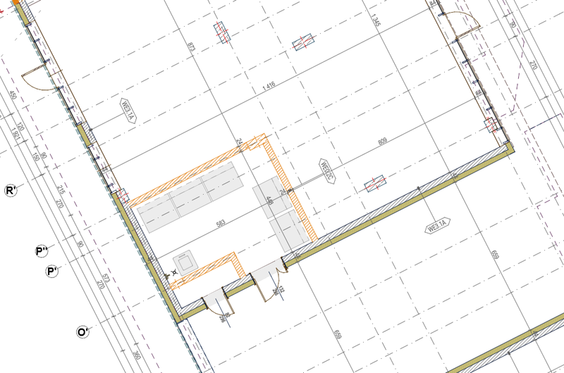

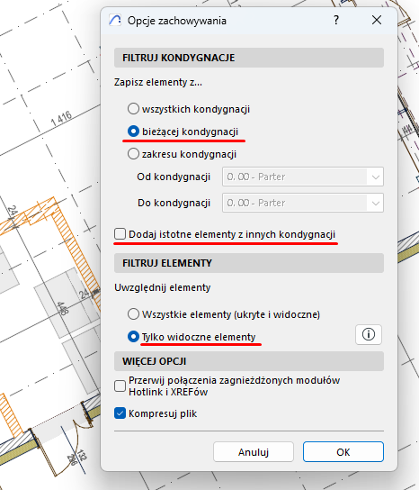

This is the base view, that is published as .mod, settings are:
-current level only
-don't include important elements from different levels
-only visible elements

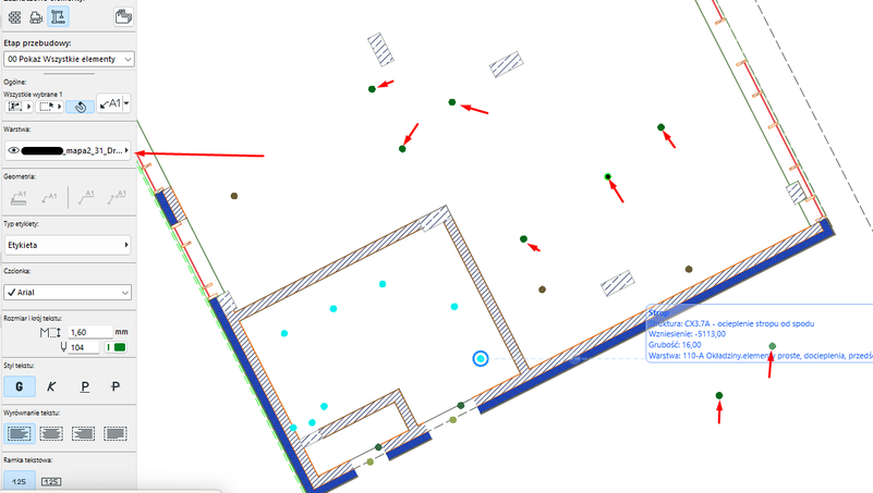

So, there's no longer elements, that are hosting the labels, no labels on the exported view, but in the .mod file:

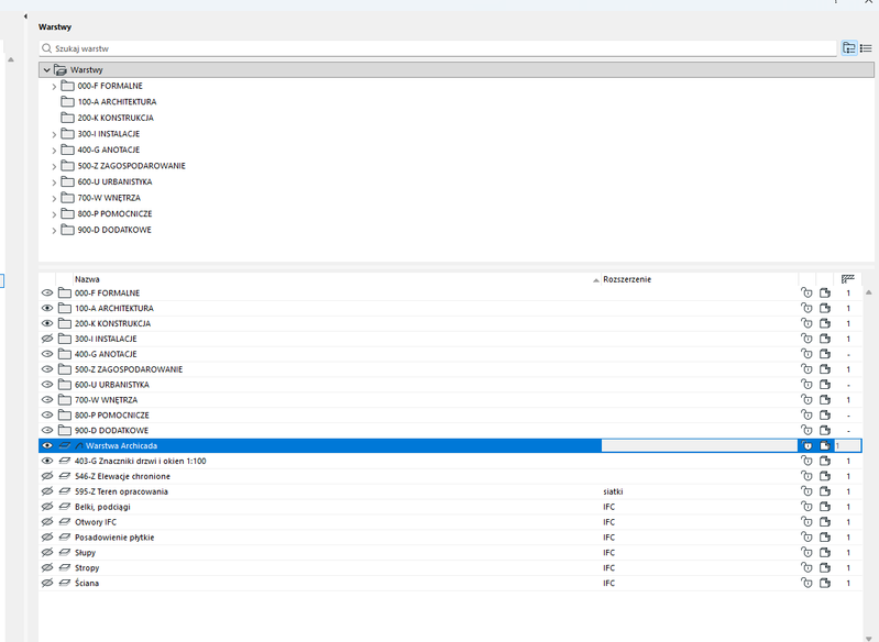

there are labels and those labels are on the layer that doesn't exist in the base file:

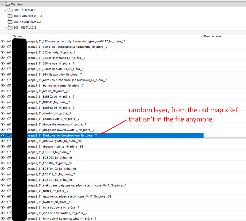

layers in the base file:
layers in the .mod file:
it looks like the layer is from the map file in dwg that was insertet as the XRef and was later deleted alongside all of the XRef layers.
I can't think of the other sollution than to manually open the .mod file, delete the faulty layer with it's content and then reload the hotlink, but that's not a sollution in the long run.

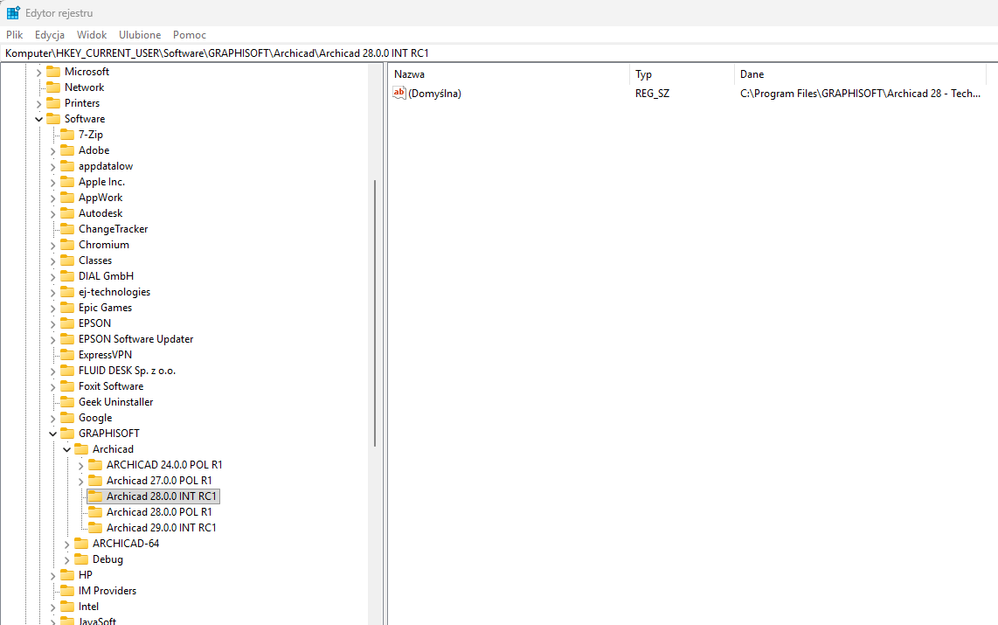

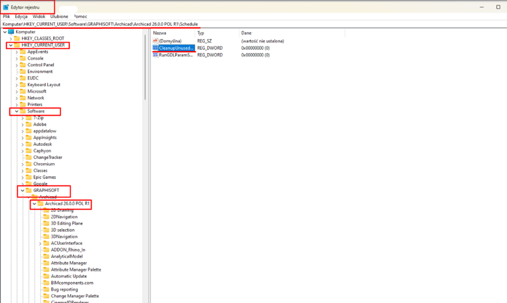

Also I was thinking about simmilar but quite the opposite issue that I had in one project, window schedules annotated with dimmensions and some 2d info were purged of this info and had to be redone at least 4 times, so there was a sollution, that required going into the registry and turning off some script that was purging "unused data" even if it was in fact used. I'll check if turning back that script helps, if not I'm out of ideas.
HSA Architektura
I can't find the registy element that I was talking about, few years back it looked like this:
now there's no scripts at all:
but the script in question was strictly schedule related, so I assume it was dead end anyways.

Can you find these label elements in the original file, even if they are "empty" or referencing objects that have since been deleted? By some smart find & select maybe?
Or I've found that labels that have the setting "hide with associated elements" will be hidden from view if their element is hidden, but it will still be exported WITHOUT their reference object leading to "empty" labels with the errors you show. The solution in that case would be to ensure that the label itself is placed on a layer that is not included in the mod export, not just its host object. Hidden != "not visible" in terms of mod export.
