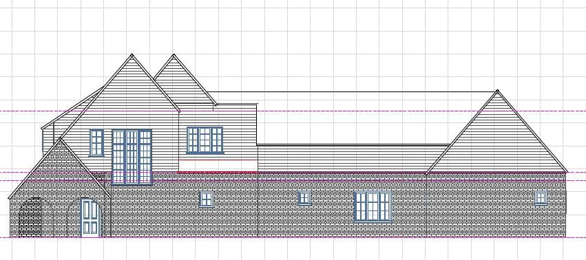

In my sections (actually pure elevations as no element is cut), everything shows up EXCEPT the roof shingles. I am struggling since upgrading to 12 from 10--many commands have been moved or changed, and I have worked through most, but this one has me stumped.
Any ideas?

Can you elaborate and/or post screenshot of your section settings?
What layer are your shingles on? etc.

Are you sure that there is a vectorial fill associated with the roof material?

Or if you were using the Roof Accessories, you'd have to download that Goodie along with its library and re-install it?

my bad. I didn't mean TEXTURE, I meant hatch. I have attached a screen shot.
Was working in a program, doing some graphic art stuff, and it refers to hatches as textures. Sorry!
The screen shot is preliminary--just trying to get something out to start the pricing exercise. See--the hatch (shingles) is/are not showing up on the roof. All other views it is fine--plan, 3D, etc..
