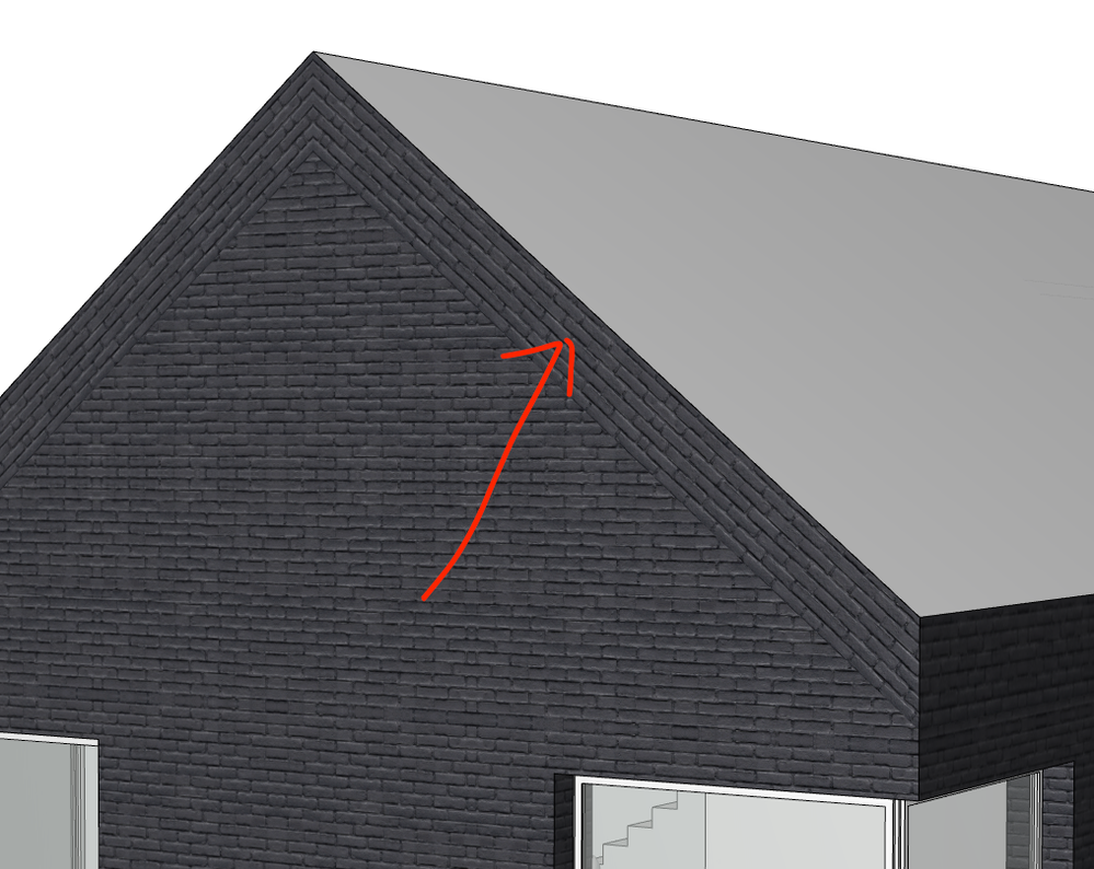

Hello, i need to rotate texture od the edge to align with the wall.
Any suggestions?
1 Reply 1
runxel
You can't rotate the texture on just a subsurface of an element.
Instead you would need to construct the model just like in real life. So the brick is part of the wall.
