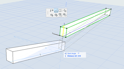

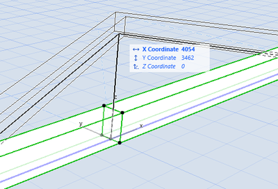

I want to move the coordinates to the z-axis.
What should I do?
I'm trying to do beam editing.
AC27 on window 11

Patrick M
yeah, thats my experience too. change them one by one.
if they are mirrors of each other, eye drop/inject should work, as their angle will invert from being mirrored in the original placement
As you showed in your image, you must use 'incline angle' in the pet palette to adjust the incline of the beam.
Adjusting the node can only affect in the X/Y planes - not the Z.
The incline angle does not work when two beams are selected because one will be a positive angle and the other a negative angle, and if the beams are different lengths, the angles will also be different.
Because these two values will be different, you can not edit them at the same time.
