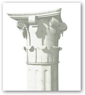

Hello, everyone.
Erich wrote:
Also, in AC 11 in the US library at least, there is only a Doric option.
In all libraries is "Column Architectural". Column contains different order. "Tuscan", "Doric", "Ionic" user accessible. "Corinthian" and "Composite" hidden from the user.
Find lines in a Parameters script:
values "ctyp" `Tuscan`,`Doric`,`Ionic`
!!!values "ctyp" `Tuscan`,`Doric`,`Ionic`,`Corinthian`,`Composite`
Rewrite them as follows:
Erich
Valery,
Thanks for the heads up on the presence of the other capitals.
I am finding that the column object is a bit buggy but perhaps I can clean the script up once I learn a bit more GDL.
